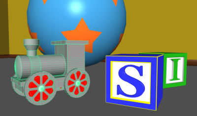

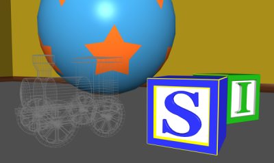

When you template an object, it is displayed as a light wireframe and cannot be selected in a view. This is useful when you want to see where an object is, but you don't want to select it.
Object is selected
Object is templated
