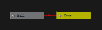

- Expression Connections
When enabled, displays a red line between two nodes that are connected by an expression. An arrow indicates the direction of the connection.
Create a NURBS sphere named Ball and a NURBS cone named Cone. Write an expression to assign the value of Ball’s translate Y attribute to Cone’s translate Y attribute. The expression links the two values. When you move Ball up or down in the view (in a Y-axis direction), Cone moves up or down the same amount.
Tip:You can change the color-coding of the connection lines by selecting Color Settings and expanding Hypergraph/Hypershade.
