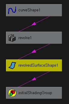

You create a wine glass surface by revolving a NURBS curve. The following dependency graph appears when you select the revolved surface’s shape node and select Graph > Input and Output Connections:
Note:This graph is shown vertically. By default, a dependency graph displays horizontally.
The connection lines between nodes show connection direction. The connection line originates at a node that outputs data, and the line points to a node receiving the data as input.
The example graph shows that a curve provides input to the revolve operation node. The revolve operation generates a revolved shape—the wine glass. The revolved shape is connected to initialShadingGroup, which sets the default color of all geometric shapes created in Maya.
If you move your mouse pointer over a connection line, a tooltip appears, identifying the output node name, the attribute that provides the output, the input node name, and the attribute that receives the input. In many cases, you must be familiar with Maya’s internal operation details to understand the node and attribute names you see in the white boxes.
