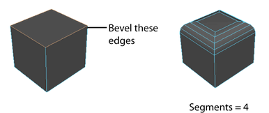

Segments
The Segments value determines the number of segments created along the edges of the beveled polygon. Use the slider or enter a value to change the number of segments. The default is 1.

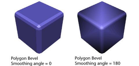

Output Smoothing Angle
Lets you specify whether you want the beveled edges to be hard or soft when shaded.
Note: In previous versions of Maya (prior to 2025), Output Smoothing Angle was named Smoothing Angle.
If you want the beveled edges to be soft, set the Output Smoothing Angle to a high value (180). If you want the beveled edges to be hard, set the Output Smoothing Angle to a low value (0).
In general, if the angle between two shared edges is greater than the value specified by the Smoothing Angle attribute, the beveled edge will be shaded to appear hard. The default Output Smoothing Angle value is 30 degrees.

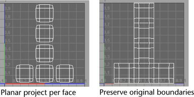

Planar project per face
Each original face is projected using a planar projection to produce UVs that incorporate the new faces resulting from the bevel. The boundaries of the original UV coordinates may be modified as a result.
Preserve original boundaries
UVs are incorporated into a UV map that maintains the UV boundaries that existed prior to the bevel. For best results, use an even value for the number of Segments.

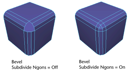

Subdivide Ngons
Subdivides any faces that have large numbers of edges as a result of doing a bevel operation with more than one segment. The Subdivide Ngons option is turned on by default and can alternately be controlled within the Channel Box.

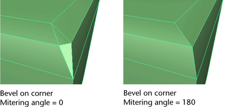

Mitering angle
Controls how two intersecting beveled edges get joined when an intersecting non-beveled edge is involved. You can specify whether you want the recently beveled edges to be mitered or not by setting the Mitering Angle value as required.
If the angle between the two beveled edges is greater than the specified mitering angle, the beveled edges will not be mitered. The Mitering Angle feature is on by default and is set to 180 degrees.

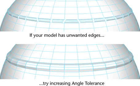

Angle tolerance
Bevel uses this angle to decide whether it needs to insert extra edges. If your model still has unwanted edges, try increasing this value to remove them.
