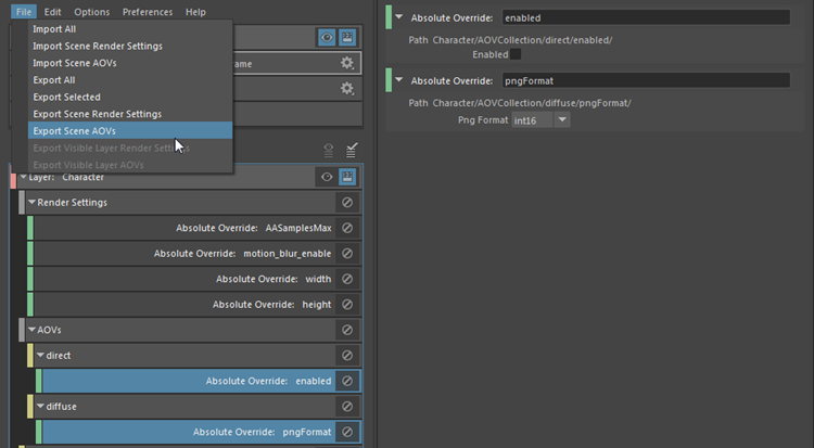

To export the scene AOVs without any override values, do one of the following:
- Select
File > Export Scene AOVs from the
Render Setup editor.
This always exports the scene AOVs without any override values, regardless of whether you are currently in the scene layer or in a render layer.

In this example, selecting File > Export Scene AOVs creates a .json that does not include the override values: the direct AOV remains enabled, and the Png Format for the diffuse AOV is set to int8, as in the scene layer.
