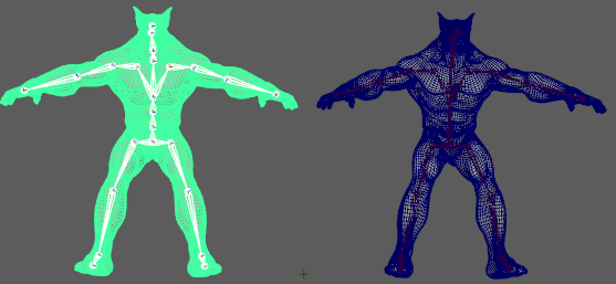

  2. Right-click the top of the character's hierarchy (for example, the hips) and choose Select Hierarchy from the contextual menu. The entire character skeleton is selected.
  3. Shift-select the Character mesh.
    Select both the skeleton and the mesh
  4. Click Source in the Bake Deformer Tool window to add your character's properties to the Source fields.

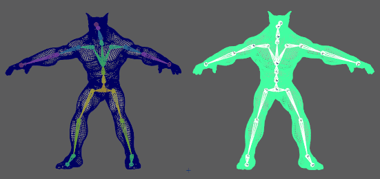

  5. Now, do the same for the destination character. (Right-click the hips joint, choose Select Hierarchy and then Shift-select the mesh.)
  6. Click Destination in the Bake Deformer Tool window to add your character's properties to the Destination fields.
