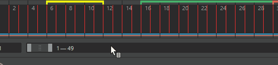

- Selecting keys on the Time Slider
- If you need to select a range of keys on the Time Slider, such as when you work with
Time Slider Bookmarks,
Shift + drag across the Time Slider. You can move the keys as long as the drag cursor
is highlighted.
Ctrl + drag to copy keys. See
Edit keys.

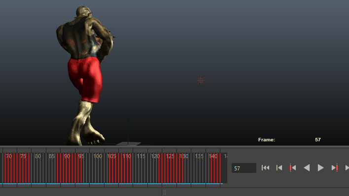

Tip: The Viewport updates when you Shift + drag keys across the Time Slider. If you don't want the Viewport to update as the current frame changes when you drag keys, for example when working on a large scene, press Shift + Alt while dragging.
Shift-dragging keys versus Shift + Alt dragging keys.

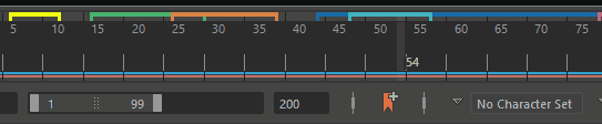

Hover over a Time Slider Bookmark to view its name
Time Slider Bookmarks are colored tags along the top of the
Time Slider that flag events in your scene. Bookmarks are a way you can draw attention to specific moments in time which is useful when you want to focus or highlight specific areas or moments in your scene. You can move Bookmarks by
Ctrl (Command)-dragging
the center of the bookmark.
Ctrl (Command)-drag the left
or the right
"leg" of the Bookmark to scale it. The Bookmark cursor changes to show that Move mode is active.
Add a Bookmark to a selected time range by clicking the Bookmark icon
in the
Range Slider or pressing
Alt (Option) +
T.
See Create a Bookmark for more.

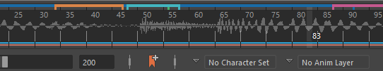

Audio
Audio Waveform in the center of the Time Slider
Right-click the Time Slider to open the Animation controls menu, where you can select the Audio rollout that gives you access to the Audio menu, where you can manage your Maya's audio settings.
When you import an audio file, its waveform shows on the Time Slider. See Display audio on the Time Slider.
