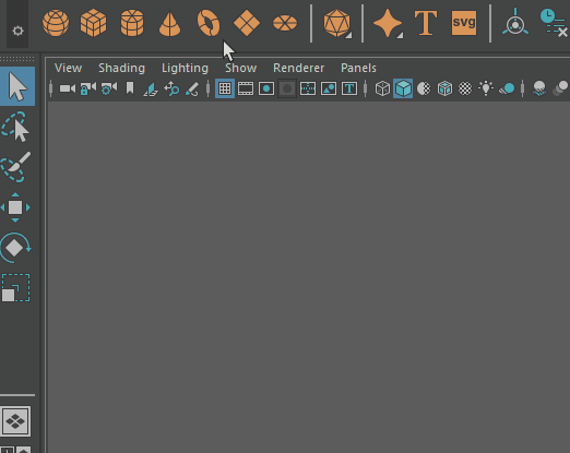

- In the Maya Panel Menus, select View > View Along Axis.

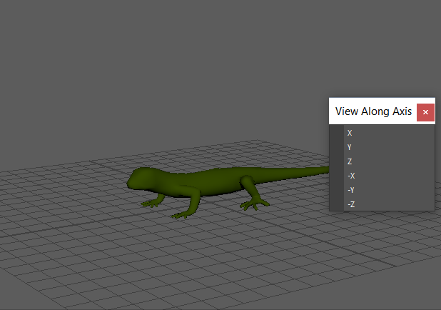

- Double-click the two dotted lines at the top of the menu to tear it off so that it becomes a separate window.
For information on creating floating menus see Tear-off menus in the Menus and menu sets topic.
- Position the View Along Axis menu where you'd like, and click the axis you would like to view.
