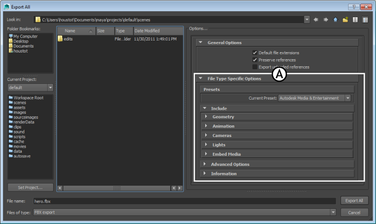

This section describes the Maya FBX Plug-in user interface which appears on the right side of the Maya Import or Export dialog box under the General options when you select the Maya Import and Export functions from the File menu.
The FBX options and menus are contained within rollout menus that you can expand and collapse.
Maya Export All window A. FBX Exporter options

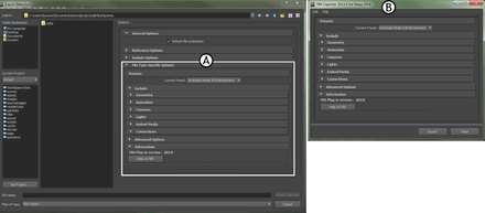

Switching the FBX UI
The Maya FBX Plug-in is available to you in two ways: the OS Native UI, which shows the plug-in in a stand alone Importer or Exporter window, or the Maya Default, which shows the plug-in as options within the Maya Import or Export dialog boxes.
Two versions of the FBX UI A. Maya Default B. OS native
Changing the UI
To switch between the OS Native “classic”-look UI and the Maya Default UI, select Window > Settings/Preferences > Preferences. In the Preferences dialog box, locate Files/Projects and scroll down to the File Dialog options.
You can also create your own presets. See Creating a custom preset.
Hiding the UI
You can hide the plug-in when it is in the Maya Default setting if you drag the center splitter bar to the right. This collapses the FBX Plug-in options.
