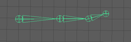

To create an IK handle on an existing joint chain
  1. Do one of the following in the Rigging menu set:
    • Select Skeleton > Create IK Handle.
    • If you want to change the IK Handle Settings first, select Skeleton > Create IK Handle > . For settings information, see IK Handle Tool.
      For example, you can use the IK Handle Tool Settings to select the IK solver you want to use to calculate the orientation of the joints in chain.
    Your cursor changes to the tool crosshair.
  2. Click the joint to use as the IK handle start joint.
  3. Click the joint to use as the IK handle end joint.
    The IK handle displays on the joint chain, connecting the start and end joints you selected.
