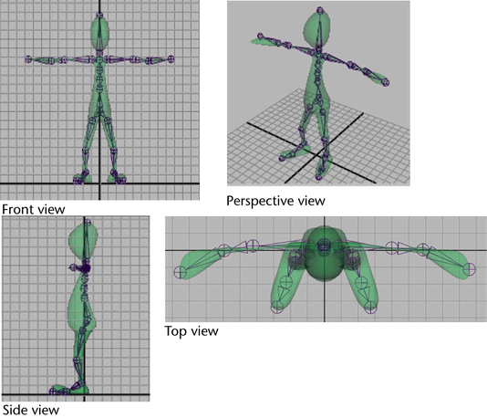

Building a skeleton is the process of placing and orienting joints to create a system with which you can pose a deformable object. Depending on the type of character you want to create, you need to place the joints where they approximate real joint positions. For example, if you are creating a skeleton for a human biped, you would place joints at all the major points of articulation in its model (shoulders, knees, elbows, spine and so on).
When constructing a skeleton, use multiple camera views to ensure that your skeleton fits its object appropriately in all three dimensions and use the display grid as a guide when judging the size and shape of the skeleton.
You can position and rescale the grid to suit your work and you can use snapping to align your joints with the grid. You can adjust the Snapping preferences in the Preferences window (Windows > Settings/Preferences > Preferences).
Tip: You can also use the Discrete Move setting in the Move Tool as a virtual grid.

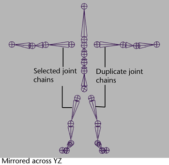

You can duplicate or create mirror copies of joint chains using the Mirror Tool. A mirror copy is a copy that is symmetrical about a selected plane. In effect, the reflection of the original joint chain in the specified plane is turned into a real copy of the original with all the aspects of the joint chain mirrored accordingly. The origin of the plane is at the parent joint of the original joint chain. When mirroring joints, joint attributes and IK handles are mirrored as well as the joints and their bones. Other skeleton data such as constraints, connections, and expressions are not included in the mirrored copy.
Mirroring is useful when creating the ‘limbs’ a character. For example, you can build a right arm and hand, and then create a mirrored copy of it for the left arm and hand.
Mirroring affects all aspects of the creation of the left arm, including the joint limits. You do not have to reset the joint limits so that the left arm’s joint limits are symmetrical to the right arm’s joint limits—Maya does this for you.

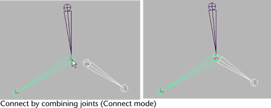

In addition to creating and extending joint chains, you can create a complete skeleton for your character by connecting joint chains or skeletons. You can do this by combining a joint from a joint chain or the root of a skeleton with any joint of another joint chain or skeleton (except its root joint). The joint chain or skeleton that becomes part of the other joint chain or skeleton changes its position in the scene so that it connects directly with the other skeleton’s joint.

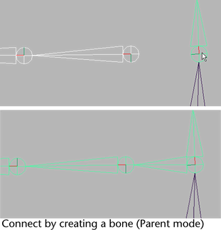

You can also connect the joint of one joint chain or the root of one skeleton to any joint of another joint chain or skeleton by extending a bone from a joint on the joint chain or the root from the skeleton to a joint or the root joint of another joint chain or skeleton. The joint chain or skeleton that becomes part of the other joint chain or skeleton does not move to the other chain’s or skeleton’s position.
