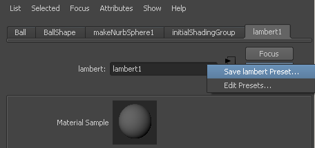

To create a preset
- Open the node you want to take presets from in the Attribute Editor.
- In the
Attribute Editor, click
Presets (to the right of the node name) and select
Save (preset type) Preset from the pop-up menu.

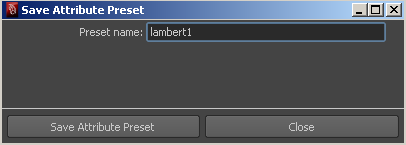

- Type a name for the new preset and click Save Attribute Preset.
If the preset already exists, you are prompted to overwrite it or save it with a different name.

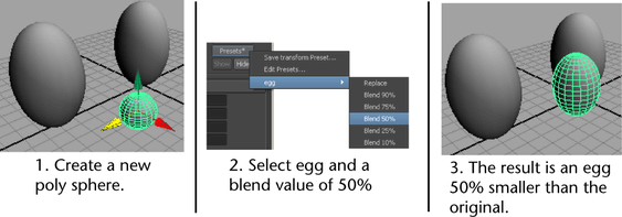

To apply a preset to another node
- Open the node you want to apply a preset to in the Attribute Editor.
- In the
Presets (to the right of the node name) to show the pop-up menu, select the name of the preset you want, then select the sub-option you want for applying the preset.
You can replace the current attribute values with the values in the preset, or blend the preset values together with the current values.
