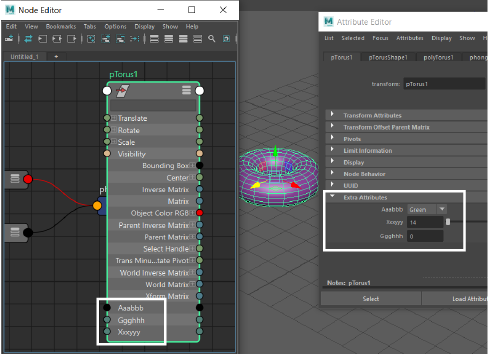

To select a custom attribute on an object
- Select the object that has the custom attribute in the Viewport, Attribute Editor, or Node Editor. Custom attributes appear at the end of the node in the node graph or in the extra attributes in the Attribute Editor.
A torus shape and its custom attributes in the Node and Attribute editors
