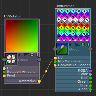

You can visualize the animation of animated shaders, for example, UVRotator (Hw Shader Nodes > Textures > UV Rotator) in the ShaderFX editor.
  1. Click the Render Swatch icon so that either the small or larger render swatch is displayed.
  2. Select Settings > Play Animated Shaders to visualize the animation for the animated shader and its downstream nodes.
Note: You can also press the Play Forwards button in the Maya Playback Controls to visualize the animation in Maya Viewport 2.0.
