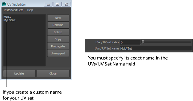

Using custom UV set names
  1. Rename your UV Sets using the UV Set Editor (Create UVs > UV Set Editor).
  2. Specify your custom UV set name in the UVs / UV set Name field.
