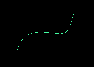

Use these options to set the attributes of the tool created when you select . See also Create a Bezier curve.
- Manip Mode
Translate and Scale Manip Modes
Determines the manipulator that appears when you select an anchor and then middle-click. You can choose Translate
or
Scale
Select Mode
Determines how you can manipulate anchor tangents.
- Normal Select
When manipulating a tangent, the tangent remains unbroken and both sides of the tangent are weighted equally when one side is scaled.
Useful for creating smooth, symmetrical curves.
- Weighted Select
When manipulating a tangent, the tangent remains unbroken, but only the selected side is scaled.
Useful for creating smooth curves weighted to one side.
- Tangent Select
When manipulating a tangent, the tangent breaks and only the selected side is scaled.
Useful for creating sharp points.
