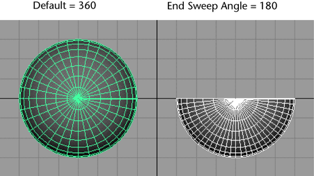

- Start and End Sweep Angles
These options let you create a partial sphere by specifying a degree of rotation. Degree values can range from 0 to 360 degrees. The following example shows the top view of a sphere with an End Sweep Angle of 180 degrees.

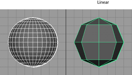

- Surface Degree
A Linear surface has a faceted appearance; a Cubic surface is rounded. For details on surface degree, see Degree.

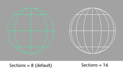

- Number of Sections
Sets the number of surface curves created on the sphere in one direction. Surface curves, also called isoparms, show the outline of the surface shape. The more sections (and spans) a surface has, the more precisely it shows surface deformations.
The following figure shows two spheres, the left with 8 sections and the right with 16 sections. A value less than 4 gives a crude sphere.

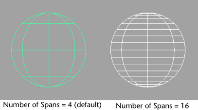

- Number of Spans
Sets the number of surface curves created on the sphere in the direction that crosses the Section direction. A value less than 4 gives a crude sphere.
