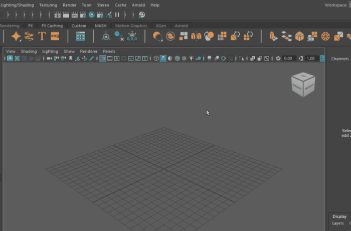

This Show menu displays above the scene view, or above each view panel in a layout with multiple scene views.
GIF screencapture of opening the Show menu in the viewport.
Use the items in this menu to show or hide specific object types in a panel.

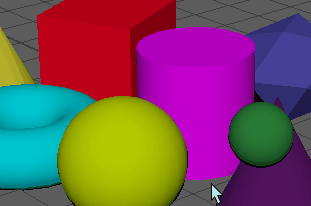

Selection Highlighting
Toggles the highlighting of elements that are clicked on or off. The default setting is on, where objects are highlighted when you select them. See the example below for an example of selection highlighting activated, followed by selection highlighting disabled.
Note: If you want components such as vertices, edges, faces and so on, highlighted as you mouse over them, see the Preselection Highlight option in the Selection preferences.
The selection highlighting menu is found at the bottom of the Show panel menu.
Toggle to hide selection highlighting.
