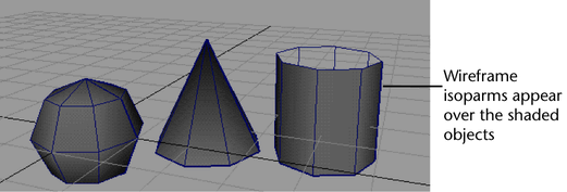

Wireframe on Shaded
Superimposes a wireframe display on all shaded objects in a view.

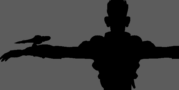

X-Ray
Displays all shaded objects as semi-transparent. This can be useful for seeing hidden parts of a model.
