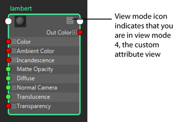

To create a custom list of attributes, right-click the node and select Edit Custom Attribute List. You can then use view mode 4 to display your node in this custom attribute view.

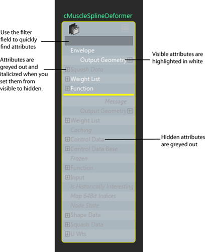

  1. Right-click the node and select Edit Custom Attribute List.
    The node switches to Edit mode and is highlighted with a yellow border. All visible attributes are highlighted in white. All hidden attributes are greyed out.
    If you have never previously edited the attribute list for this node, then all the attributes for the node are listed, and all primary attributes are set as visible. In other words, the visible attributes list is the same as that of view mode 3.
    If a custom list currently exists for this node, then the attributes are listed as they are saved in the list.
    The node is drawn without any connection ports and all connections are drawn in grey. The node is also locked in place and you cannot make any connections to the node being edited. (If you try to make connections to another node in the Node Editor, you will exit out of Edit mode.)
  2. Toggle your attributes to set them as invisible or hidden:
    • To make an attribute visible, toggle it so that it is highlighted in white.
    • To hide a visible attribute, toggle it so that it is greyed out and italicized.
    Note: Use the filter field to quickly find the attributes that you want to set as visible or hidden.
  3. Change the order of attributes in the list by middle-dragging the attributes.

Display the custom attribute view
To display the custom attribute view, you can do one of the following:
  • Use the 4 hotkey
  • Click on the Node Editor toolbar
  • Cycle through the view mode icon on the top right corner of the individual node to
  • Select Edit > Custom Mode
As with the other view modes, you can display the custom attribute view for an individual node, for selected nodes, or for all the nodes.
