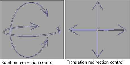

    Rotation and/or translation redirection controls appear at the root of the current character set. The Create Character Set Options window remains open.
  9. Do the following:
    • Move the rotation redirection control to change the position around which your character pivots.
    • Move the translation redirection control to change the current character’s position relative to the position around which your character pivots.

    • Click Redirect. The rotation and/or translation redirection controls appear at the root of the object and the Character Redirection Options window closes.
    • Click Apply. The rotation and/or translation redirection controls appear at the root of the object and the Character Redirection Options window remains open.
  6. Do the following:
