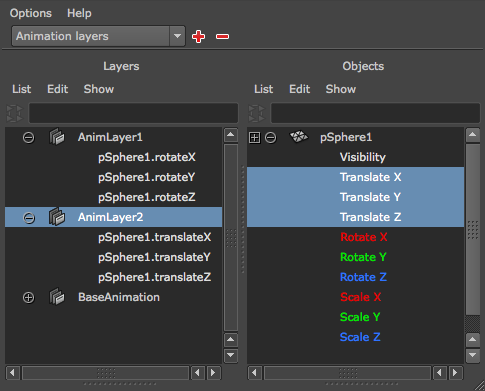

To add or remove attributes using the Relationship Editor
- Select the object whose attributes you want to add or remove.
- In the
Animation Layer Editor, select
Layers > Membership.
The Relationship Editor opens, displaying all of your animation layers in the left side panel, and the selected object(s) in the right side panel.
- In the left side panel, select the layer you want to work with.
Tip:
You can also expand the layer to confirm which attributes are assigned to it.
- In the right side panel, expand the display of the selected object to view all of its attributes.
Any attributes that are already assigned to the selected layer are highlighted.
- Do the following in the right side panel to add and remove attributes:
- To add an attribute to the layer, click any attribute that has not already been assigned to the selected layer.
The attribute is added to the layer, and its name is added beneath the layer name in the left side panel. In the right side panel, the attribute is highlighted to indicate it is a member of the selected layer.
- To remove an attribute from the layer, click any highlighted attribute.
The attribute is removed from the layer, so it no longer displays in the left side panel and is no longer highlighted in the right side panel.
