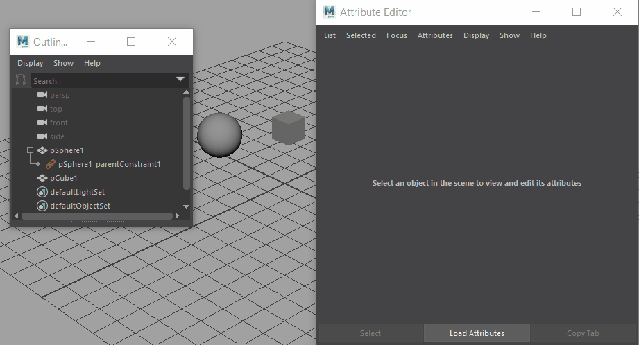

Changing Display attributes for an object
The Display attributes set the overall display settings for the current object, and are found on the Transform tab (the tab with the object's name) in the Attribute Editor.
