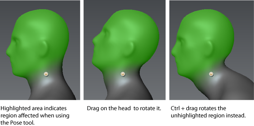

The Pose tool rotates, translates, or scales the regions of a model associated with a joint. Any region that displays weight color when the joint is selected will be affected. The saturation of the green color weighted region indicates how much it is affected by joint. You can modify the region of influence for a joint using the Joint Weights tool (see Adjust a joints region of influence).

  4. Click-drag on the model component or the joint, keeping in mind that the stylus/mouse button controls the deformation that occurs in relation to the joint as follows:

    Click-drag the weighted region to rotate the component about a rotational axis that is normal to the current camera view.

    To transform model components not within the weighted region selection.
    Press Ctrl and click-drag with any button to perform any of the above transformation operations on un-highlighted components of the model after the joint is selected.
