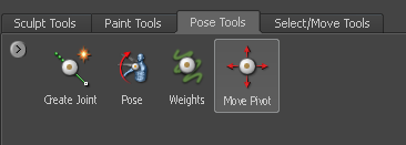

You can reposition joints using the Move Pivot tool. The Move Pivot tool lets you translate the pivot for the joint based on the viewing plane of the camera.

  1. In the Pose Tools tray, select the Move Pivot tool.
