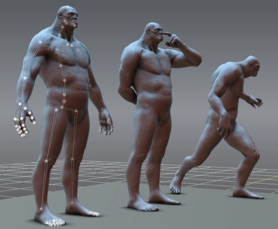

For example, you can use the posing tools to place a character model in various positions and stances, to deform components, or change component proportions. You can deform and shape non-character models just as easily by moving, bending, or twisting their components.
You can import and pose models with skeletons rigged in other applications (such as Maya, 3ds Max, and Softimage) using the FBX file format. For example, to perform range of motion tests and determine whether the proportions of the arms allow the fingers to reach a character’s face, and so on.

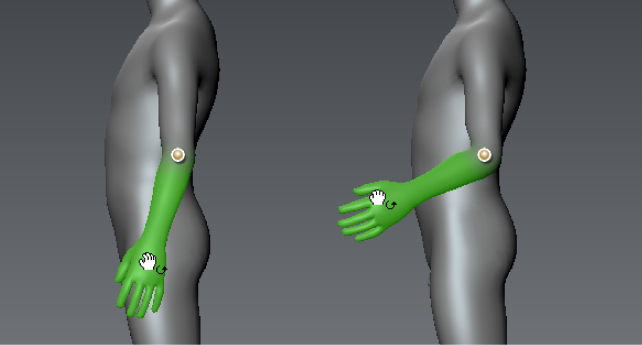

Select the Pose tool and drag a highlighted area to pose it. This rotates the selected region in relation to a rotation axis that is normal to the current camera view.

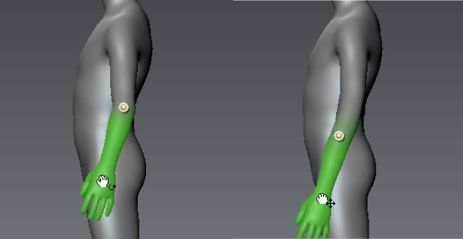

Middle-dragging a highlighted region moves the region within the camera viewing plane.

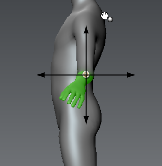

Click-dragging directly on a joint rotates the component about vertical and horizontal axes that lie planar in relation to the current camera view.

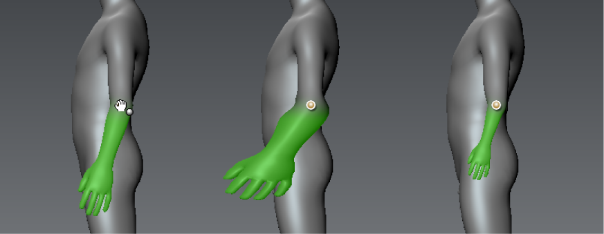

Middle-dragging the joint scales the selected region non-proportionally, or proportionally when you press the Shift key.
