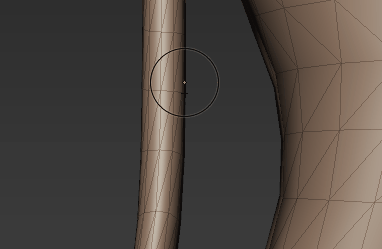

Orient To Surface
Orients the tool cursor display (in the 3D View) along the normal of the face under the center of the cursor ring. Influences cursor display only, does not influence the effect of the brush on the surface.
