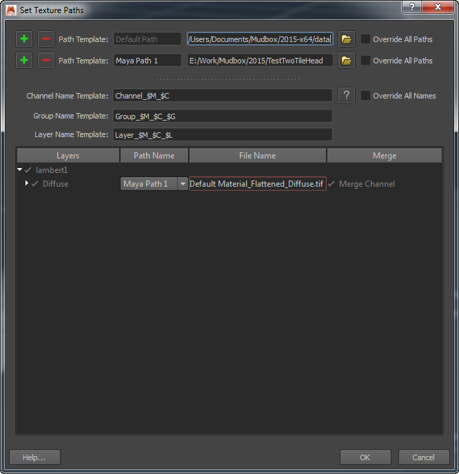

    The Set Texture Paths window appears.
  4. (Optional) In the Path Template text box, enter the file path or click the folder icon to choose a folder location.
  5. (Optional) Specify channel, group, and layer names in the names for the Channel Name Template, Group Name Template, Layer Name Template text boxes.
    For more information on the Path Template, Channel Name Template, Group Name Template, and Layer Name Template, see Export All Paint Layers window.
    Mudbox stores all new textures in the disk and remembers the texture path. The stored textures are referred for making subsequent updates to the Maya scene.
  6. Click OK.
  7. The updated textures are referenced correctly in the Maya scene.

    If there are new textures created, then Set Texture Paths window appears. In the Path Template field, you can enter the export path for these new textures.
