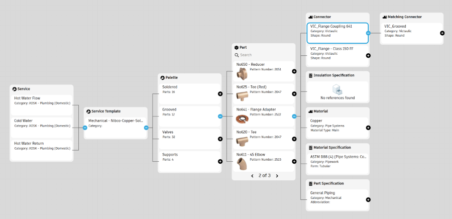

Use the Relationship Manager in MEP Content Editor to view and manage the relationships between items in a fabrication configuration. The Relationship Manager provides a visual display of the associated and connected elements for a selected item in the configuration.
The Relationship Manager is helpful when you want to purge unused data and need to check where a part, connector, or material is used. You can also use the Relationship Manager to identify and resolve data issues. See Data Health.
Select an item and click hierarchy-relationships-24 Relationships to view the item and its relationship to other fabrication items.
relationship manager connectors
To modify an item, move the mouse pointer to display the three dots and click Edit.
relationship manager edit
You can set the focus to an item to view all its relationships in the configuration. For example, you can set the focus for a part and then explore the Service Template and Palette on the left and the connectors, material, and specifications on the right. Move the mouse pointer to display the three dots and click Set Focus.
relationship manager set focus
