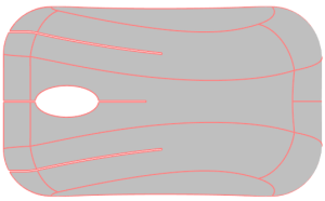

(Home tab > Import panel > Import).Navigate to the location where you saved the tutorial files.
Select the file MouseCover.ipt and click Open.
Select Dual Domain from the drop-down list. This is the most suitable mesh type for a thin shell-like part.
Click OK.
