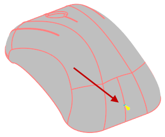

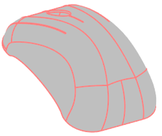

Rotate the part so you can see the back of the mouse, similar to the image.
Note: The part has been selected in these images so that the CAD contours can be shown. This shows that the body has been selected. Do not display these contours during this task because there is a risk of the body being deleted at the same time as the injection location.Click
(Home > Molding Process Setup > Injection Locations).Click the part on the back end of the part as shown. The exact location is not important.
Click Fill Preview in the Study Tasks pane.
