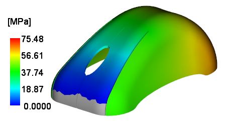

Pressure at V/P Switchover result
Click Pressure at V/P switchover in the Study Tasks list.
Rotate, Pan, and Zoom the model as necessary to inspect the result.
Click
(Results tab > Animation panel > Play) to animate the result.Rotate the part similar to the plot.
There is a significant pressure difference at V/P switchover between the areas of concern. The inner tabs are blue so they have a pressure of zero, and the corners by the tabs are green and have a pressure of about 40 MPa. This shows an imbalance in pressure and filling and can be a cause of warpage.

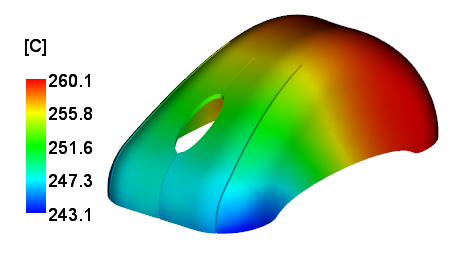

Temperature at Flow Front result
Click Temperature at flow front in the Study Tasks list.
The outer corners are cooler than the inner tabs by about 3C. This difference is caused in part by the unbalanced filling but the difference is not significant.
