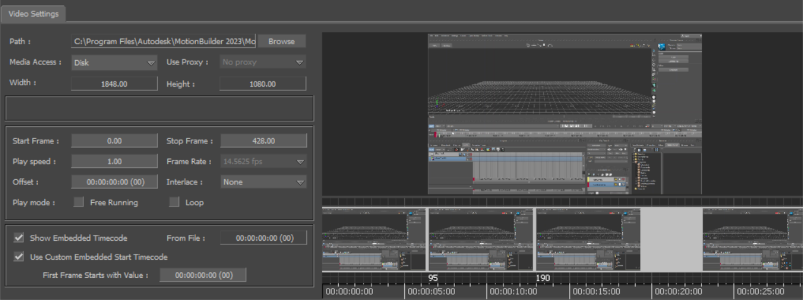

Video settings
The Video settings let you select various file and playback options for the current video or image.
Video settings

Video Media viewer
The Video Media viewer displays the selected image or video. When the video plays in your scene, it also plays in the viewer.
If a video is selected, the Video Media viewer shows the frames of the clip beneath the video preview. Ctrl-drag the video frames to zoom in or out.
