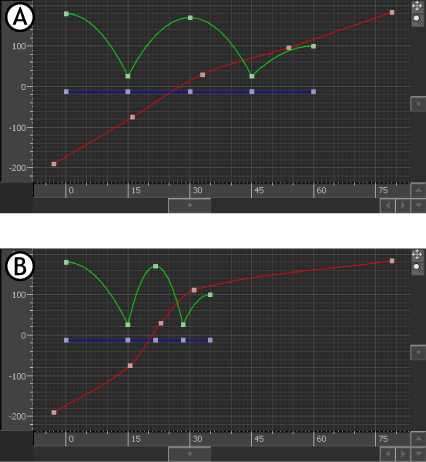

For example, the following illustration shows the FCurve of an animation curve and how you can use FCurve scaling to tighten the selected keyframes.
FCurves pane A. Original bouncing ball curve B. Curve scaled to create tighter bounce

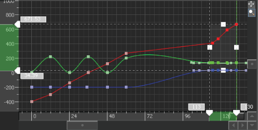

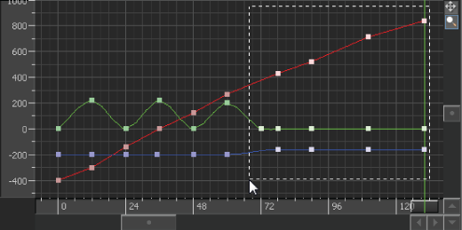

  1. Drag across a group of keyframes on a curve to select them. In this example, the keys that are on the flat end of all curves are selected.

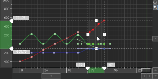

  2. Ctrl-Middle-drag them inward to shrink or outward to expand the selected keys on the curve. Dragging the white handles inward or outward results in the same behavior. In the illustration below, the keys are shrunk together on the curve.
  3. Release Ctrl and drag the selected area closer to the active part of the animation, where the green T-axis curve is wavy.
  4. This scales the selected area.
