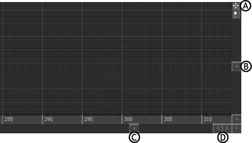

The scroll bars, arrows, and buttons in the FCurves pane let you change the view in the FCurves pane. You can also change your view using keyboard shortcuts.
FCurves pane A. Pan and Zoom buttons B. Side scroll bar C. Bottom scroll bar D. Scroll arrows

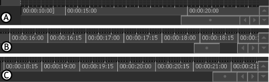

Where you Ctrl-click is the reference point for scaling your view of the curve. The view scales around this reference point. Dragging from left to right scales the view horizontally, while dragging up and down scales the view vertically.
FCurve timeline A. Original timeline B. Scaled timeline C. Scrolled timeline
