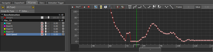

    The FCurves window displays the comparison parameters for the analyzed curve.
  5. To view the analysis, in the FCurves window under _CA, select one of the following comparison parameters to plot its curve in the FCurves window:
    • Pose —as a relative difference in percent or absolute difference in degrees.
    • Root rotation—as a relative difference in percent or absolute difference in centimeters.
    • Root height—as a relative difference in percent or absolute difference in degrees.
    • Root X and Z direction—as a relative difference in percent or absolute difference in degrees.
    • Root speed—as a relative difference in percent or absolute difference in centimeters per-second.
    By default, the values represent the difference in the pose as a percentage from 0 to 100, where 0 means no difference to the target frame, while 100 means greatest difference to the target frame.

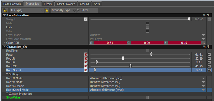

  6. (Optional) To see absolute difference values, do the following:
    • In the Navigator, click the Properties tab,
    • Under Settings, click beside a comparison parameter mode, such as Root Speed Mode, and select Absolute Difference (cm/s).
  7. (Optional) To analyze the curves as you drag the timeslider (scrub) along the timeline, turn on RealTime in the Properties tab under _CA.
