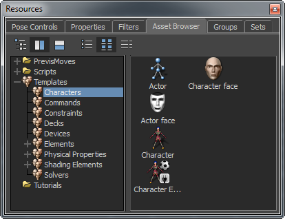

To add a Character Face to the scene:
  1. Click the Characters folder in the Asset browser.
  2. Drag a Character Face asset into the Viewer widow.

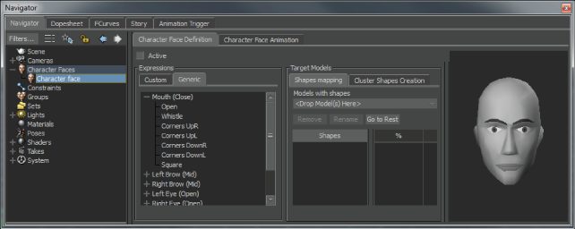

    The Character Face settings display in the Navigator window.
After you have added a Character Face to the scene, you can begin to define the expressions for your character’s face.
