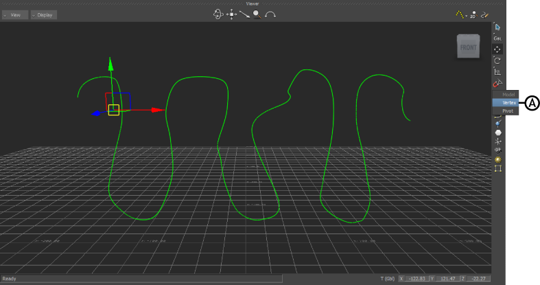

  1. Select the 3D Curve.
    In the Viewer window, the color of the 3D Curve changes from red to green, indicating it is selected.
  2. Click the Translate button or press T to activate the Translation mode.
  3. Select Vertex from the Viewer toolbar Object Selection menu.
    Viewer window Object selection buttons A. Vertex.

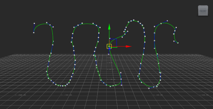

    The points on the curve transform into editable points with tangent handles.
    3D path in Edit/Delete Points mode.
  4. Double-click any point on the curve and translate the point or its handles. Ctrl-click a point to deselect it.

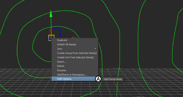

To add points to a curve:
  1. Right-click the curve and select Path Options Add Points Mode from the context menu. The cursor changes to a crosshair.
    3D path context menu A. Add Points Mode
  2. Click the mouse in the Viewer window to add a point to the end of the curve.
    • To add a point to the beginning of the curve, right-click instead.
    • To add a point inside the curve, middle-click.
  3. Press Escape to exit Add Points mode.
