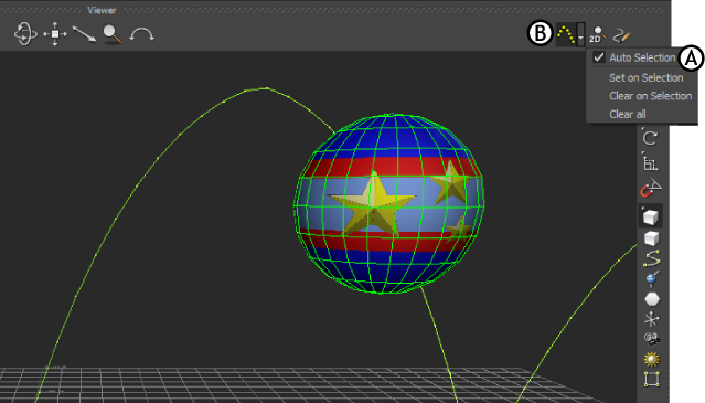

To view the trajectory of an animated object:
  1. Select the object, and click the Trajectories button at the top of the Viewer window.
    Viewer window A. Trajectories menu B. Trajectories button
  2. Click the down arrow next to the Trajectories button to open the Trajectories menu and select one of the following:
    • To view trajectories for all selected objects, select Auto-Selection.
    • To view trajectories even when objects are not selected, select Set on Selection.
    • To hide the trajectories of selected models, select Clear on Selection.
    • To hide all trajectories, select Clear all.
