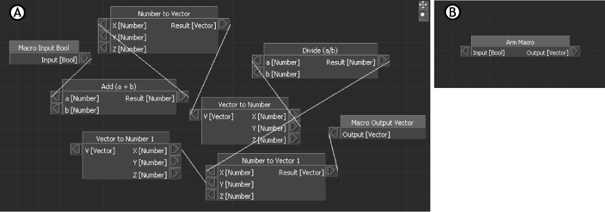

Macro constraint A. A Relations constraint named “Arm Macro” B. “Arm Macro” used as a Macro in the Relations pane.
The Macro becomes a single relation, representing the entire set of constraints within that Macro; all the Input-Output Relations constraints used in your Macro become connectors on that relation.
