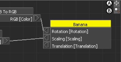

At the upper right of the Relations pane, there are two buttons you can use to move around the pane, the Travelling button and the Zoom button.
Relations pane Navigation buttons A. Travelling B. Zoom
- Dragging the Travelling button lets you pan around the Relations pane. You can also Shift-drag in the Viewer window to pan in the Relations pane. You can also Shift-click and drag to scroll through the pane.
- Dragging the Zoom button lets you zoom in and out of the Relations pane. You can also Ctrl-drag in the Relations pane to zoom. To zoom in on a specific area, Z-click and drag a box around the section you want to expand.
