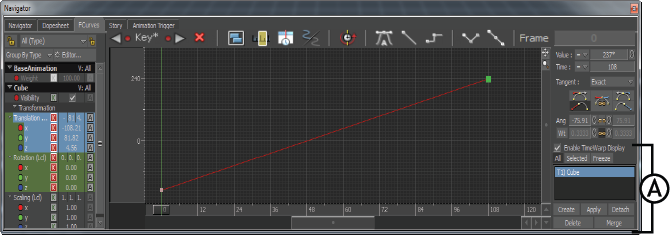

When the TimeWarp pane in the FCurves window is active, all changes such as editing, selecting, keyframing, and other actions apply to the selected function curve’s TimeWarp curve.
A. TimeWarp pane

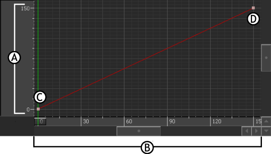

In TimeWarp mode, the original time code is graphed by the TimeWarp time code. The vertical axis shows the time values for the original animation, and the horizontal axis shows the time values for the TimeWarp animation.
A. Original animation values on Y-axis B. TimeWarp animation values on X-axis C. Beginning of time D. End of time
