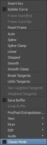

Isolate Curve | | Displays only the selected function curves in the FCurves pane. You can also activate this option by selecting Isolate Curve from the context menu. See FCurves context menu. |

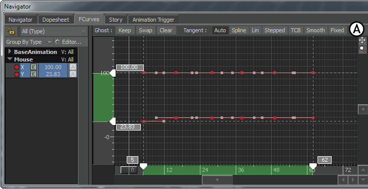

FCurves pane in Classic Mode
To view the FCurves pane in Classic Mode, right-click in the FCurves pane and choose Classic Mode from the context menu.
The FCurves pane in Classic mode and the options in the classic toolbar are shown in the following figure:
FCurves pane in Classic Mode A. Options in the classic toolbar
