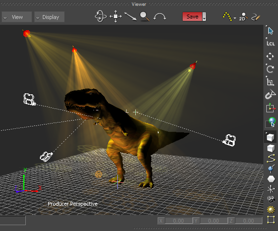

Camera navigation controls
Select a camera navigation control to enable it. Either left-drag or right-drag to move the camera the desired way in the Viewer, such orbit, dolly, zoom.
ControlResultShortcut Key
Orbit
Left-drag revolves the current camera view around the camera interest.
Right-drag orbits the camera interest around the camera.
Ctrl-Shift-drag
Ctrl-Shift-right-drag
Travelling
Left-drag pans the camera and the camera interest.
Right-drag slides the camera without moving the camera interest.
Shift-drag
Shift-right-drag
Dolly
Left-drag dollies the camera without moving the camera interest.
Right-drag dollies the camera and the camera interest.
Ctrl-drag
Ctrl-right-drag
Zoom
Left-drag zooms the Viewer window, in and out.
Z-drag
Roll
Left-drag rolls the camera from side to side.
Right-drag rolls the camera by increments of 15 degrees.
R-drag
R-right-drag
