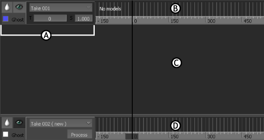

Cut area
The Cut area is where all of the tracks for your edit are stored. Each track contains your blending object, a cut or a pose, and values that define when your character uses specific motion data.
The result of your edit depends on the placement and the size of the cuts and poses on each track.
To navigate in the Cut area, Ctrl-drag to zoom and Shift-drag to scroll. The Force Time option affects navigation in the Cut area. See Force Time.
Track list A. Take box B. Track C. Cut area D. Result track
