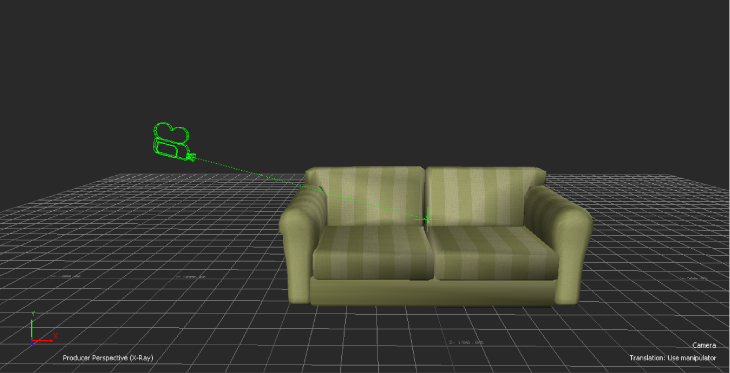

  1. Activate the Camera Interest option in Camera settings View area to show or hide the camera interest that is represented by a separate object in the scene.
  2. Switch the view mode to Normal or X-Ray mode by pressing Ctrl-A.
    The camera interest is always placed at the center of the scene. The camera is shown with a dotted line that ends with a “+” (Cross) symbol.
    The “+” (Cross) symbol is the camera interest, or focal point, and the dotted line shows the camera view’s path.
    Note: The Properties window shows the attributes for the selected camera interest.
  3. You can select the Camera interest from the Schematic view or Viewer window.
    A Camera with its interest
  4. Switch the view mode to Normal or X-Ray mode by pressing Ctrl-A.
    Camera views A. A custom camera viewed through the Producer Perspective B. The custom camera view.
