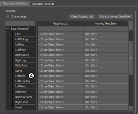

  4. Switch to the Character Definition pane and view the Mapping List. Expand the Base (required) group of slots.
    Character Definition pane A. Base (required) objects
    The words currently display for each required slot in the Mapping List because the bones in the model have not yet been mapped.

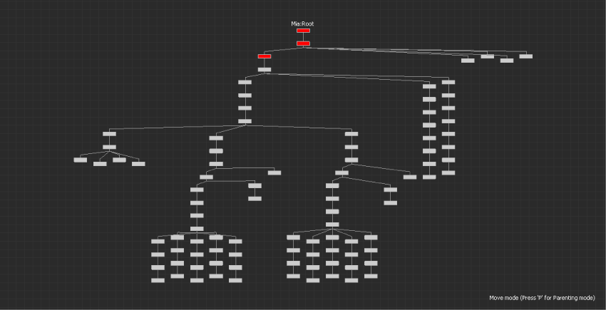

  5. In the Viewer window, switch to the Schematic view (Ctrl-W), then press A to frame the hierarchy. Each of the bones in your character’s hierarchy are represented by rectangular nodes.
    Character hierarchy in the Schematic view
    You may find it easier to select bones using these nodes in the Schematic view.
  6. Select a bone, then Alt-drag it into the Mapping List of the Mapping List. Drop each of the bones in the character into the corresponding slot of the Mapping List.
    For example, if you select the left thigh bone in your character model, you would Alt-drag it into the LeftUpLeg field in the Mapping List.
    Repeat this step until you have dragged all of the required bones into the Mapping List. The Character mapping is now complete.
  7. Activate the Characterize option at the top of the Mapping List.
  8. A dialog box appears to remind you that your model must be in a stance facing the positive Z-axis. Choose between two types of postures for your character (Biped or Quadruped) to continue.
After characterizing your character, you cannot make any changes to the Mapping List. To make changes, you must disable the Characterize option to remove characterization.
