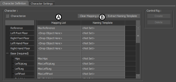

About the Mapping List
The Mapping List in the Character Definition pane includes required and optional slots that let you define the skeleton of your model. The Character asset uses the objects defined in this list to link your character model to a motion source.
A. Mapping List B. Naming Template column
The Mapping List contains all the data that MotionBuilder needs to understand the structure of your character and how it can move. It contains the list of bone names that MotionBuilder understands.
For any skeleton that you introduce, MotionBuilder requires that you map a minimum of fifteen objects to the Base group of slots.
