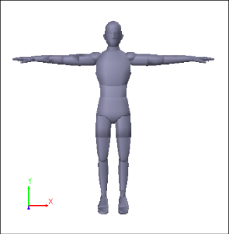

Body Color
Lets you modify the RGB color values that define the color of the Actor in the Viewer window. By default, the Actor displays in grey.
Default Actor color

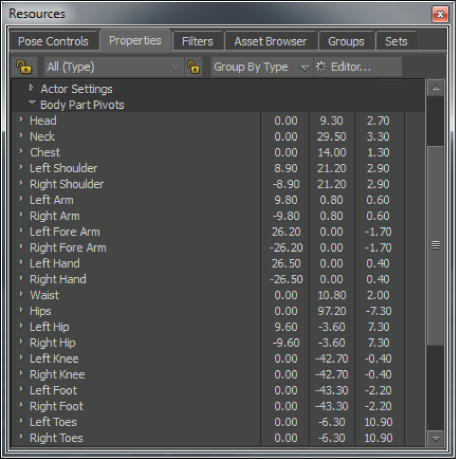

Body Part Pivots
Let you define the position for each pivot point associated with the Actor.
Body Part Pivots properties
