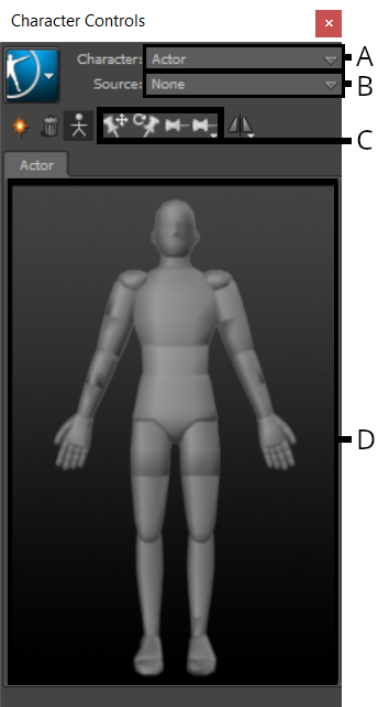

Actor Controls window A. Character drop-down list B. Source drop-down list C. Effector pinning buttons D. Actor representation
Displays the name of the current Actor to which all options apply. When switching from an Actor to a character using this menu, the options in the Actor Controls window are replaced and become contextual to the current character.
Select an Actor in the Actor Controls window by making a selection from the Character drop-down list.
Actor Representation
The Actor is divided into cells that represent the joints of the Actor. Selecting a cell lets you manipulate that part of the Actor using Inverse Kinematics.
Cells in the Actor representation can have the following states:
State | Indicates |
T | A segment containing the letter T indicates that its corresponding body part is pinned in translation. |
R | A segment containing the letter R indicates that its corresponding body part is pinned in rotation. |
T and R | A segment containing both T and R indicates that its corresponding body part is pinned in both translation and rotation. |
Empty | An empty segment indicates that its corresponding body part has no translation or rotation pinning. |
Highlighted | When a segment is highlighted, it indicates that the corresponding body part is selected. |

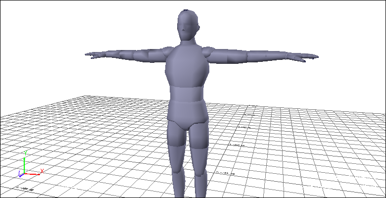

Collapse | Activate Collapse to rejoin any detached limb segments of an Actor without resetting the Actor’s size or stance. This may be necessary in certain situations. For example, when adding position offsets to an Actor or when translating source markers further than their initial definition, some limbs may detach to reach all the markers defined by its Marker set. |

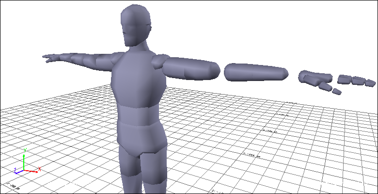

Reset Size | Select Reset Size to reset the scale of the selected Actor to its default size. If a scaling offset affects the position of a segment, Reset Size resets the scale of the Actor, but leaves the segment at its new location. |
Reset Size resets the scale of the left arm but keeps the position of the left hand, detaching segments of the arm

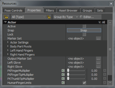

Edit Properties | Select Edit Properties to open the Properties window and display all the properties associated with the selected Actor. These properties let you change, activate, and disable various Actor properties. The Name, Active, Snap, Lock, and Marker Set properties also appear in the Actor settings. |
Actor properties display in the Properties window
